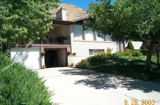

I have a patio attached to my house (like in the image below) like in this picture
As you can see, it is covered and over my garage. Although it is covered, it still gets rain and snow on it and, unfortunately, the top decking material is just painted OSB and it is seriously rotting. Under the OSB is good flat framing. I am going to rip out the OSB and I want to add a waterproof deck top, but understand that if I do that, I need to add slop.
My main question is this: how do I add slope to the existing frame? (I am assuming that there is none).

Slope is quite easy. 3 ways. First, is to cut full length wedges out of 2x4's or bigger & screw them to the top of the sub-floor at the joist locations. Second, is to remove the sub-floor too & sister-on pitched or sloped 2x4's or bigger. Third, is to use concrete or cement over the sub-floor & new decking, the floor needs to be real stiff to avoid future cracking. Typically, just 1/8" per foot is enough to keep everything heading out ...anything more is better.
Yes, a level should easily indicate if the floor is already sloped outward or not or even sagged in either direction. As far as good waterproof material. I'd probably opt for a 3/4" plywood (not OSB) with Cement Board on top of Options 1 & 2 for all taped & cemented seams & screw heads to then be covered in Concrete Resurfacer.
This would just need an Exterior Masonry Sealer to prevent dusting &, if desired, could be painted with a porch or garage floor paint. Glued-down Aluminum Diamond Plate Panels or Textured Thick Plastic Sheeting would be my next option, seams would just be caulked & painted (so they stay nice looking). I wouldn't try to protect any kind of wood though, as you've discovered it's a failure waiting to happen...this is true whether sloped or not.

just rib out the osb, rip some lengths of spruce 2x4 or 2x6 to give you the slope you want. just make these tapered cuts so that the minimum thickness is approximately 1". nail and construction adhesive glue them to the tops of the existing joists and then put new a new subfloor and a rolled asphalt roof on top.
you can use a laser transit or level to establish the datum for the existing structures slope. you can rent these everywhere or just buy a cheap one. once you know how it currently slopes or crowns/bows/saddles, you can tune your surf cuts to give you the exact slope you want so that the whole thing is perfect when done.

well first is to slope the floor. you have quite a few options. then obvious like everyone stated is use a wedge under the plywood.since your cutting it out and replacing it. that would be a good option.
All slopes that interact with water. (except roof pitch and pools) Building code minimum 2% slope(1/4 inch per foot) That goes for a balcony,concrete patio or soild floor deck.To Slope away from the house or to a drain(outdoor,indoor or shower).Also the pipes for sceptic,sewer and runoff drains should slope a minimum 1/4"per.ft.
