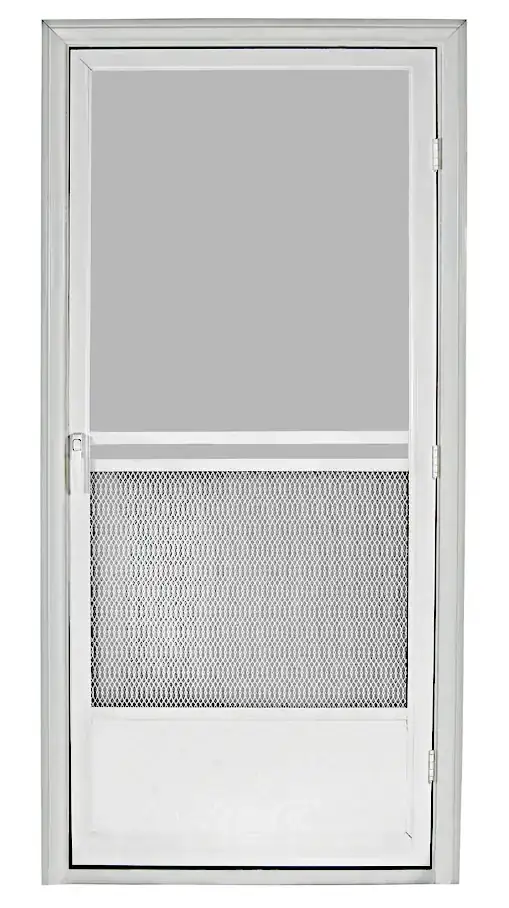

1/8" or 1/4" hardware cloth (galvanized or stainless steel mesh, which a string trimmer can't cut - also a stock pet protection measure) over the screen. Rather than the "poke through the edges of the screen" method suggested in the first comment, this is normally screwed right to the face of the door, with some trim, 12-18" high (or the bottom screen panel, depending on door design.)
