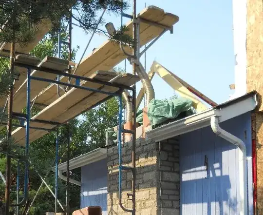

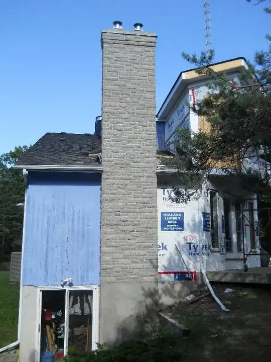

We have a house that is one storey in places and two storey in others. The chimney is freestanding above the first storey. Recently we added a second-storey room, and had to extend the chimney so it was enough above the new roofline. This meant about 13 feet of freestanding.
chimney
You can see it's well connected and footed at the base.
We were required by code to add a "saddle" that braced it back to our roof. Here you can see them working with a mockup:

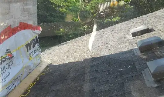

The real brace went back with a flat line, not that angle as the mockup. The masons built the chimney with flat spots to make it easier to caulk the saddle.
flat spot

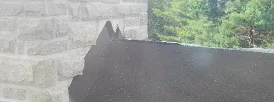

Eventually the saddle was finished just like the roof, including vents. Here it is in progress:
brace partly finished
Your saddle would probably be very similar.
