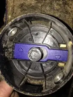

Here is a picture of the auto feed mechanism, including spring (on the left side) which is in place properly as far as I can tell. Even though the area around the spring looks like its full of debris in the picture it is actually just some surface dirtiness, it does not effect the spring at all.

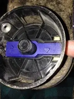

Here is same but showing the mechanism depressed by my finger pushing the button. The spring gives some resistance.

Based upon the additional pictures it seems that the clutching mechanism is that blue plastic piece that slides back and forth. The spring pushes the wider part of the blue slider toward the center. In this position the line spool should be able to turn letting out the line. As the motor spins up and the mechanism begins to rotate fast the wider (and thus heavier part) of the blue slider moves out away from center overcoming the spring tension due to centrifugal forces. This action should cause the line spool to lock so that it cannot rotate.
From the pictures it would appear that the spool lock is based upon the two triangular shapes sticking up from the blue plastic slider. These must need to engage with stops on the top side of the spool to keep it from rotating.
You can test the mechanism for proper operation by first pushing the blue part against the spring tension and see if the thread spool locks in that position (Lock in this context probably means that the thread spool is constrained in the line unwind direction only as the device only turns one direction).
The possible problems that I can think that may be wrong are:
  1. The blue slider part is not moving freely enough.
  2. The blue slider part gets pinched somehow when installing the thread spool keeping it from moving correctly when the centrifugal forces come into play.
  3. The spring is too strong.
  4. You are starting up the tool on too low of initial speed (applicable of unit has a variable speed on/off control).
  5. Stopper nubbins on the top of the spool are sheered off or worn away.
  6. The spool is not getting seated fully when installed so that the stops on its top are not in the same plane as the triangle shaped stops on the blue slider. (This could be due to installing some washer it spacer in the wrong place).
