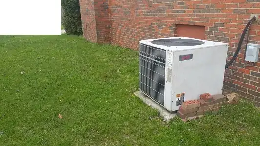

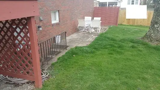

EDIT: here are some requested pictures.
Front Right Front Right Right Side From Front Right Side From Back Back Side Left Side From Back Left Side From Front Front Side from Left

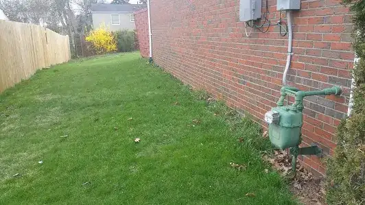

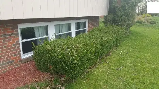

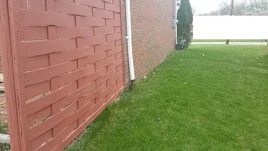

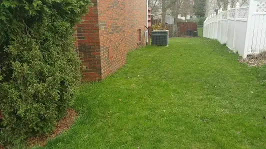

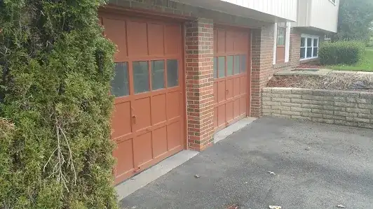

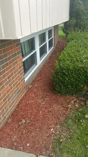

The Gas Meter (may be the picture angle), Front & Driveway sides all look good. The patio should be ripped out & redone with a properly pitched concrete slab, re-grading would be part of that job by default. But really, only the AC's side would need to be re-graded at any point or in your lifetime. But, put elbows on your gutter downspouts, they aren't helping matters at all.

Hmm, judging by the pictures you posted, it doesn't actually look like you need to do a lot of regrading. The only place it appears the lawn slopes towards you house is along the side with the AC unit. Especially if you're near the top of the hill, you aren't getting a lot of runoff.
In terms of grading it yourself, it's completely doable, but it's going to be a few weekends of shovel-work, plus re-seeding the lawn.
From my experience (working for a landscape contractor a few years, and ownership of one house in the pacific northwest) you'd be better off installing a french/curtain drain along the one side that slopes towards your house, and keeping an eye on any standing water during the rainy season.
