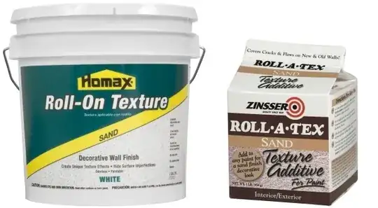

I have knocked out a couple walls and never really made it fit right with the ceiling pattern - Is there an easy way to replicate this ceiling texture?

Caulk the hairline cracks. Pick out the nail pop plaster, screw the nail or screw back in with an adjacent screw to hold it in, spackle & prime. Then, re-paint the ceilings with a Sandy Paint or Add Sand to any paint.
Roll-on the new paint for everything. But then, go back with a brush to do a 2nd or 3rd coat with a brush. The brush will let you swirl & build-up any flat areas for a pretty perfect match quite easily.
sandy paint

you can just spray it with a latex base sand texture coating (like stucco but finer)
http://durabond.com/products/plaster-acc/sandex/
you will have someone in your area that makes something similar.
Get a bucket of drywall compound, some "PVA" primer, a 1/2" lambswool roller, a small container of plaster and a "Magic Squeegee" ( a very wide very flexible rubber blade). Thin a gallon or so of drywall compound at a time in a bucket with the primer till it's a thick but liquid (rollable consistancy). Add a cup full of plaster. Take the roller, soak it in water... ring it out thoroughly and roll on your concoction onto the ceiling. You will then gently use the squeegee to flatten it out and eliminate roller marks. Take your time and go slow... you'll have at least an hour before it starts to set up
