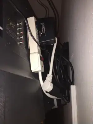

To make my television mount look clean I ran a new extension cord, the tv plug and the cable wire through a wire management system that sticks on the wall. The extension cord is plugged into a 2 foot surge protector which is taped to the back of the tv as is the cable box ( it's very small). The only thing plugged into the surge is the cable box.
Is this safe? Nothing is run through the wall.
surge plugged into extension

Technically, this is not okay. Wiremold® and other similar products are not typically listed for use with power-supply cords, cordsets, or other similar cables. They're designed to contain data, communications, and audio video cables. See this answer for more details.
Check the manufacturer's documentation, to determine exactly what types of cables are allowed in the specific product you're using.
As for plugging the surge strip into the extension cord, that's definitely not allowed. There should be a label on the strip, or in the documentation included with the strip that says not to plug it into another strip of extension cord.
UL White Book 2013
Relocatable Power Taps (XBYS)
...Relocatable power taps are intended to be directly connected to a permanently installed branch circuit receptacle. Relocatable power taps are not intended to be series connected (daisy chained) to other relocatable power taps or to extension cords.
The common solution to this problem, is to use a kit designed for this, like the one described in this answer. Though with a system like this, you'll have to cut holes in the wall.
If the wire management channel is a listed raceway, then you shouldn't be running power and communications cables through it together. Unless the raceway is divided for the entire length.
National Electrical Code 2014
Chapter 8 Communications Systems
Article 800 Communications Circuits
800.133 Installation of Communications Wires, Cables, and Equipment.
(A) Separation from Other Conductors.
(1) In Raceways, Cable Trays, Boxes, Cables, Enclosures and Cable Routing Assemblies.
(d) Electric Light, Power, Class 1, Non–Power-Limited Fire Alarm, and Medium-Power Network-Powered Broadband Communications Circuits in Raceways, Compartments, and Boxes. Communications conductors shall not be placed in any raceway, compartment, outlet box, junction box, or similar fitting with conductors of electric light, power, Class 1, non– power-limited fire alarm, or medium-power network-powered broadband communications circuits.
Exception No. 1: Where all of the conductors of electric light, power, Class 1, non–power-limited fire alarm, and medium-power network-powered broadband communications circuits are separated from all of the conductors of communications circuits by a permanent barrier or listed divider.

Yep, no problem at all. The setup should be under 250 watts (TV plugged into cable box). If the extension cord ever gets warm to the touch, then you'll want to go to a thicker wired extension cord.
