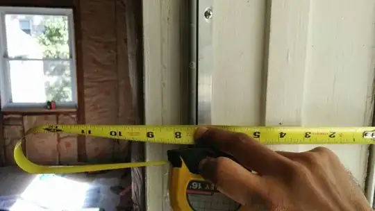

I've an entryway with a 9 inch jamb. Jamb
I'm planning on buying a slab door and building a custom jamb.
Few questions :
  1. What kind of wood is the best for exterior door jambs ?
  2. How do I extend the threshold ? The one that comes with the door is made of aluminum.
  3. Are there any potential issues I should watch out when building a custom jamb ?
anset
