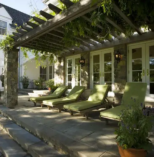

In the picture below, these beams span pretty far, but they are also very thick and I wonder if beams that thick can be mounted to a 6x6.
