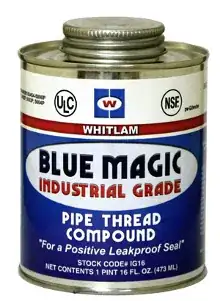

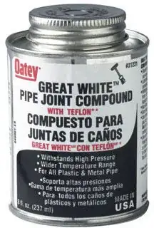

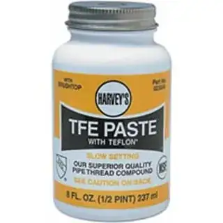

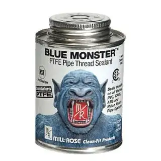

Pipe dope is a general term used to describe any lubricant, sealant, or adhesive designed to aid in making pipe joints leak proof. It can be used to describe dopes in various forms, including pastes, tapes, putties, etc.
Within the plumbing trade, the term "pipe dope" is commonly used to describe paste dopes exclusively.
Using a general term such as "dope", prevents specific brand names from being used to represent an entire class of products.
http://rads.stackoverflow.com/amzn/click/B002L6G050 http://www.supplyhouse.com/Blue-Monster-76003-Blue-Monster-Heavy-Duty-Industrial-Grade-Thread-Sealant-with-PTFE-8-oz
https://diy.stackexchange.com/questions/21066/what-goes-on-threads-first-tape-or-dope http://www.mastercraft.com/teamtalk/showthread.php?t=66985 http://www.gfthompson.ca/pipes.html
https://www.etnasupply.com/index.jsp?path=product&part=12535&ds=dept&process=search&qdx=0&ID=%2CPlumbing.Supplies%2CChemicals%2CPipe.Dope%2Cdept-3SZ
All sources may be found in the image descriptions. Products are shown for educational purpose only and are not to be viewed as endorsement. Intending to include all major North American manufacturers, any additions are welcomed.
Pipe Dope Trade Names:
  • TFE Paste
  • PTFE Pipe Thread Sealant
  • Pipe Thread Sealant
  • Pipe Joint Compound
  • Pipe Thread Compound
Do not confuse plumber's putty with [Pipe/Thread/Joint - Dope/Paste - Sealant/Compound].
