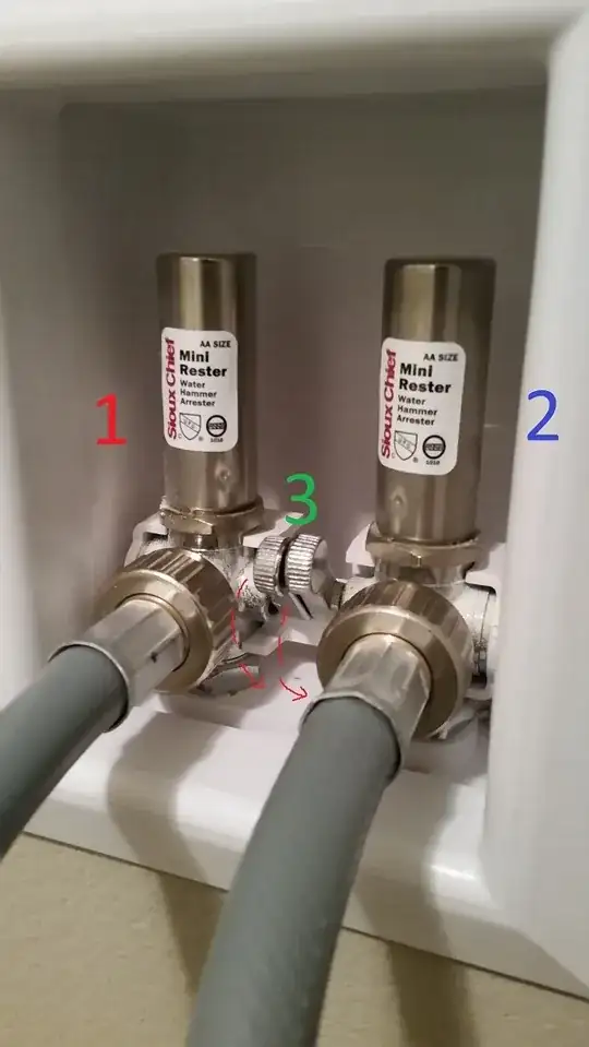

I am trying to install my new washer & dryer combo. There are a few things that I am not sure since plumbing hardware and markings are a bit different in the US compared to once I used in Russia.
Please take a look at the photo and help me figuring out:
  • does the left (marked as red "1" on the picture) pipe provide hot water, while the right (blue "2") -- cold water? I saw that on many pictures in the Internet, but I am not sure whether the convention is reliable.
  • do I turn water on by turning down the handles marked with a green 3?

In the US you can almost always (almost... there's certainly exceptions) rely on hot being on the left and cold being on the right. This will be the case for washing machine hookups, bath tubs and faucets. I'm not sure if that is a code requirement anywhere, but it is almost universally used. Switching sides would have safety implications because someone would assume the right handle was cold and could be scalded when it ends up being hot.
So...
  1. This is the hot.
  2. This is the cold.
  3. These little levers are where you turn the water on or off.
Also, note that in different regions and even from house to house the valve types can vary quite a bit. The values you have pictured are very modern and sleek and have built in water-hammer arresters. Some houses would just have two gate valves like you would use for an outside water hose with red and blue handles. Sometimes the two valves are linked and only have one handle that turns them both on or off. This Google Image Search shows the wide variety of types out there.
