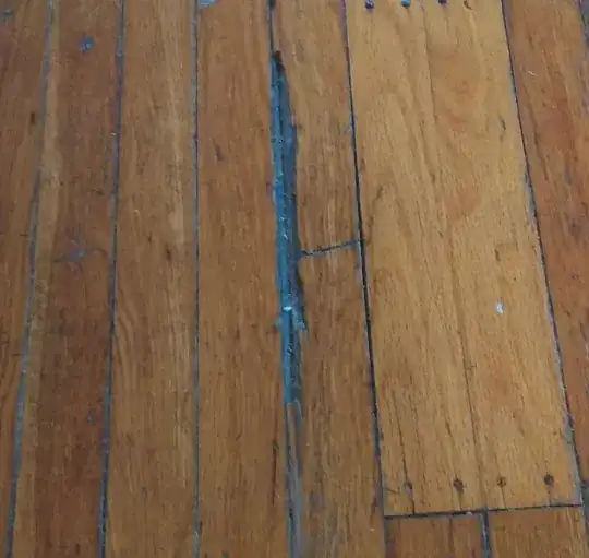

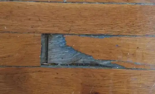

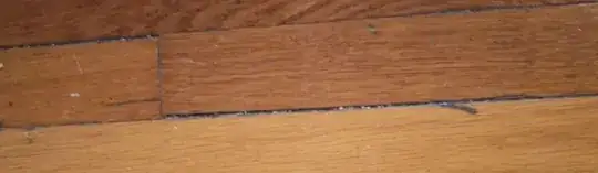

The floors in this home are likely original from the 1920's. The lovely owners of the house before me did not care much as it was a rental, and we now have tons of paint and holes on and in the floors.
I'm going to refinish the floors because of the excess of scratches and paint marks. I'd love to be able to fix the holes as well.
From what I understand, the two options are to 1) use wood fill, 2) let poly fill the holes.
What is the best way to make holes such as the ones below look good?
Large: Large
Medium: Medium
Small: Small

The only long term solution is to replace the boards. As others have mentioned, wood filler cracks out and in some cases looks like cat litter after a while. The reason is that the wood expands and contracts as the humidity changes between the seasons.
Replacing the boards is not as difficult as it seems, but the repairs will stick out unless you refinish that section of the floor. Theres a great 'this old house' video which demonstrates how to do this.
For the small gaps, the recommended solution, from a couple of floor refinishing professionals, was to leave them as character. Filling them will crack out, replacing them will be a ton of labor and may end up with the same cracks in the end - especially depending on what season you're in.
Ulad Kasach
  • 432
One of the nicest floor I've ever seen was in a small grocery store in San Miguel, CA. Built in the 20s or 30s, it shrank quite a bit and had been well worn from foot traffic. Each night it was liberally doused with pinesol and water, and left to dry. Every now and then it was oiled. I was gorgeous, rustic, authentic.
Basically, don't worry about the nicks and cuts and stuff. Sand if you want just to keep splinters away, oil, and enjoy. Tung oil is good. You can also just wax it with a good floor wax.
There does appear to be some form of structural damage beneath the damaged boards. Any kind of 'patch' or replacement may bring similar results over time. I would cut out and remove the entire section of board, inspect the joists and proceed from there. Once structural soundness is evaluated, buy replacement flooring, using a cut-out section for best match. You can often find decent replacement planks at a building salvage yard at a reasonable price.
Solid plank flooring is tricky. Once damage is removed, if you don’t feel confident doing that task, I would get a wood floor pro to do replacement. Removing damaged floor yourself will save some on cost, but if not confident, you could create damage more expensive to repair.
If this process is too much for whatever reason, I would sand out the damaged areas and fill with plastic wood putty. The result will not be beautiful, but you can make it acceptable and reduce trip hazard.
