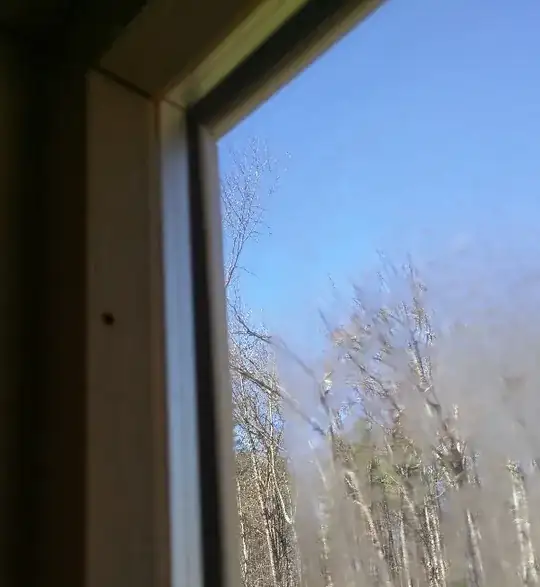

Recently I asked Is there a way to remove condensation and clean inside a double pane window? The answer appears to be "no", at least not without resorting to very dangerous chemicals.
Two of the windows in my house with failed seals are on an unheated porch. For these windows, I don't see any reason why I need to have double panes. I don't need the insulation that the double panes provide.
I'm thinking that I could just remove one of the panes. Is it possible to safely remove one of the two panes? What technique should I use?
If I do so, should I remove the inner our outer pane?
The two windows in question are fixed windows (they don't open). They were installed when the house was built 20 years ago. They are above a sliding door, so they are fairly high off the ground. The gap between the panes appears to be about 1/2 inch.
