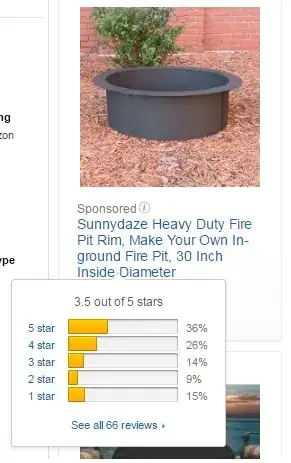

Edit: An example of the ring I was talking about

Edit2: Product reviews are probably important when you can't get the actual specifications. Amazon has reviews for the example product that you linked... 3.5 stars is not so hot.
