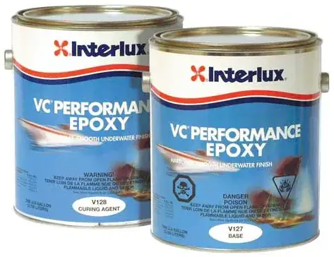

Real epoxy comes in 2 cans. You mix them together in a mixing cup, and you have a limited "pot life" to apply it and clean the spray gun. Which is why they can't sell it in rattle cans.
manufacturer stock photo of 2-part Interlux epoxy in 2 cans.  They are both gallons and are the same size.  What is with that Photoshop job?
