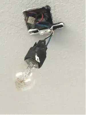

I'm a big time novice but determined not to hire an electrician for what is probably a simple job. This is embarrassing, I think. Here is an exposed light fixture that I have in my attic exposed lamp

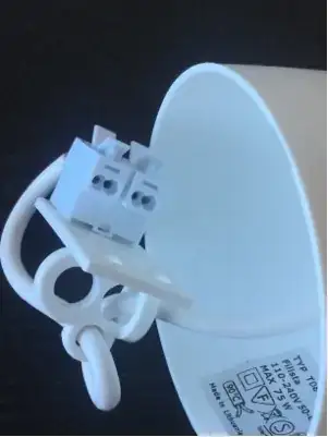

I want to install this simple Ikea lamp, but I'm dumbfounded by what is expected from me.
I guess I need to remove the black thing in which the light bulb currently is screwed and plug insert those wires into this contraption. Am I at risk for being electrocuted? Also: Am I correct that it doesn't matter in which hole I put the blue or black wire?

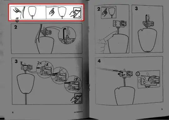

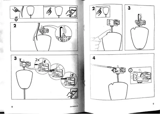

Still, being kind of used to deciphering these kinds of instructions, let me decode this picture puzzle for you, and provide the "missing captions" that the instructions should've included. For clarity, I'll do this panel by panel, and highlight each panel above its explanation:
Panel 1
Panel 1
You can attach this light fitting either directly to wires coming from a hole in the ceiling (as in your case), or using a cord that runs along the ceiling surface (e.g. if you want to install it at a spot where there isn't a convenient access hole available).
In the former case, follow the instructions on this page; in the latter case, follow the instructions on the next page instead. (That's what the little arrow and the page-flip icon are supposed to mean. That's probably the most confusing part about the instructions right here.)

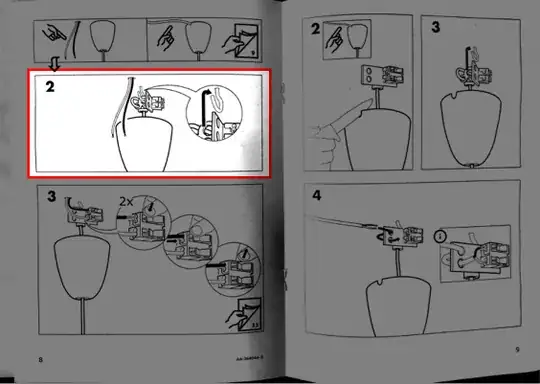

Panel 2 (left page = direct attachment)
(Since you're attaching the lamp directly to wires coming from the ceiling, these are the instructions you should follow.)

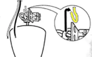

Panel 2, left page
You will need a mounting hook in the ceiling to hang the lamp from. Do not just hang it from the wires! If you need to install your own hook, make sure it's solidly attached (e.g. drilled into a support beam, not just into a flimsy fiberboard sheet) and will bear the weight of the lamp.
(In your case, you might be able to attach a suitable hook to the existing mounting bracket, but it's probably better to remove it and replace it with a hook that attaches directly to the ceiling.)
The picture shows the correct hole to use to hang the lamp from the hook. Do not use the other holes; they may not properly bear the weight of the lamp!

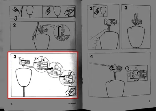

Panel 3 (left page = direct attachment)
Panel 3 (left page)
You will then need to attach the wires to the connector block. While the instructions don't actually mention it (at least not on this page), you should obviously turn off power to the fixture first, preferably at the main circuit panel, and verify this with a voltage tester. Also make sure that nobody can accidentally turn the power back on while you're working on the light.
Another thing the instructions don't explicitly mention is that, in your case, you'll first need to remove the existing "sugar cube" screw connector along with the currently installed lamp, leaving just the wires (black and brown in your photo) coming out of the ceiling.
To attach the wires to the connector, press the rocker switch on the connector, insert the bare end of the wire into the hole, and release the switch. You may want to give the wire a gentle tug to check that it stays in. Then repeat this for the other wire. (That's what the "2x" presumably means.)
The actual electrical work should be done at that point. You are then instructed to flip to page 13, but since you haven't shown us a scan of that page, I can't tell what it's supposed to say. (If it's anything like these assembly instructions I found for another version of the same lamp, it's probably about assembling the lampshade.)
Note: In the IKEA instructions, the black wire (shown going into the upper hole in the connector) is the live one, and the white wire (going into the lower hole) is the neutral, as shown e.g. on page 4 of the PDF manual I linked above. You can consult e.g. the Wikipedia page linked by RedGrittyBrick to find out which color means live and which means neutral in your part of the world. The lamp will work even if the wires are swapped, but doing so can make it slightly easier to get shocked if you accidentally touch the inside of the bulb socket while changing the light bulb, so getting them the right way around is recommended.
Incidentally, looking at your photo, and the various color combinations listed on Wikipedia, I suspect that 1) you're living in Australia or New Zealand, 2) the brown wire is the live one, and 3) your current bare bulb socket is wired the wrong way around. That's just a guess, though.

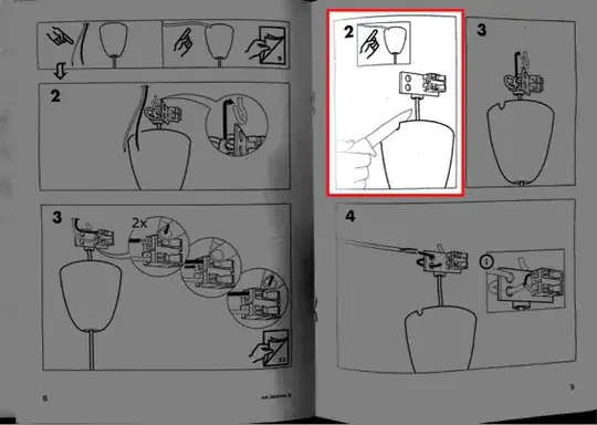

Panel 2 (right page = indirect attachment)
Panel 2 (right page)
If you want to attach the lamp to a surface-mounted power cord, you'll first need to cut a notch for the cord in the plastic cone thingy. (I have no idea what the proper name for that thing is.) Otherwise it won't sit flush with the ceiling, and will look ugly.

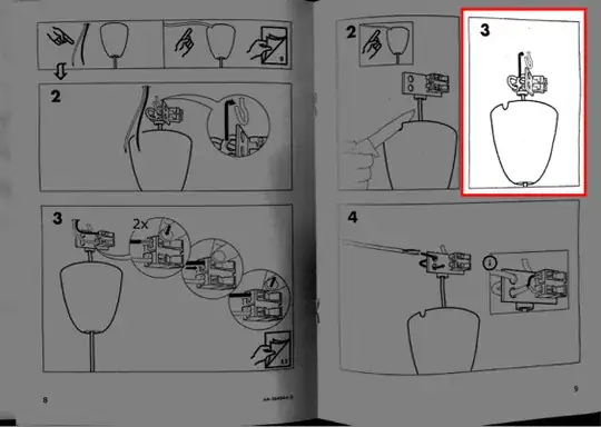

Panel 3 (right page = indirect attachment)
Panel 3 (right panel)
As before, you will need to hang the lamp from a hook in the ceiling. Make sure to use the correct hole for the hook.

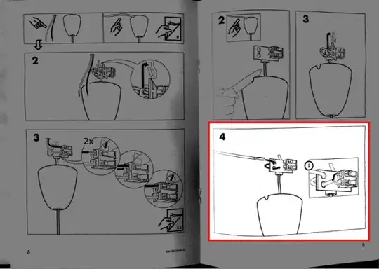

Panel 4 (right page = indirect attachment)
Panel 4 (right panel)
To make sure that the power cord doesn't get accidentally torn off from the connector block, thread it through the two holes on the connector assembly as shown in the picture. (That's what they're for; you're not supposed to hang the lamp from the hook using them.) Then insert the bare ends of the live and neutral wires into the connector, as shown on the previous page.

If you look at the picture you sent of your existing setup you can see 4 colored wires going into a white square thing called a terminal block, aka chocolate block. It looks like a setup you'd find in the UK or Europe. The purpose of the terminal block is to join the wires coming from the electrical supply to the wires of the light. To do this job you would (after shutting off the breaker) loosen the screws holding the 2 wires going to the electrical supply and pull them out. Try to keep them from touching or you could trip your house's protection system (if you have one) and the whole house goes dark. Once you have the old fixture disconnected you will then need to get if off the ceiling.
