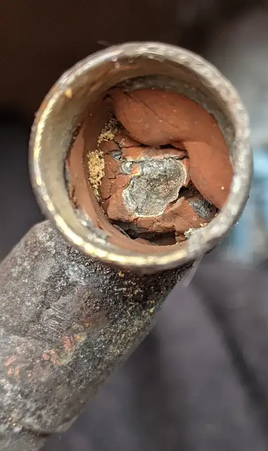

Excess solder (as you might add while trying to fix a leak improperly, on the theory that if some is good, more must be better) is not benign - I have personally hunted down a pipe that had pressure when there was no flow, but almost no pressure when the valve was open; having eliminated the valve as a cause, I took the pipe apart joint by joint, and found one elbow almost filled with solder, with just a tiny hole water was making it through (that's inside the pipe, where there was supposed to be a 1/2" hole.)
My image of nearly plugged joint
