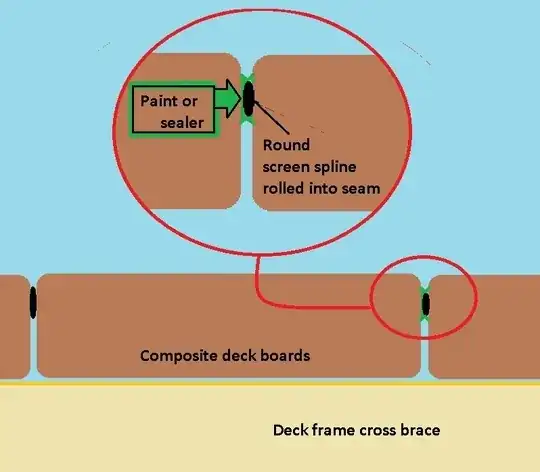

So I'd like to know what type of additional sealer (see picture below) - either a paint or a self-leveling fluid caulk I could apply into the seams (on top of the spline) to eliminate the small leaks that still occur in places where there are very small gaps between the deck boards and spline.
(Note - the screen spline was rolled into each seam and it sits about 1/4 inch below the deck surface. The seams are about 1/8 inch wide. Each deck board is one piece, 7/8" x 6" x 11 foot) Ideally I'd like to apply some kind of sealer that is about as viscus as water so it would flow down the slope of the seams and into the small gaps that are currently allowing rain water drips...
I'm thinking a thinned house paint or a semi-harding, enameled deck sealer might do the job - - setting up somewhat flexible to allow for expansion and contraction...I understand that I would probably need to redo this every couple years...I really don't want to use regular caulk if I can avoid it.enter image description here

Sooner or later the splining will deteriorate, and whatever sealant you put in may as well. Also, you are creating little pools in the gaps that may be breeding grounds for mosquitos in wet weather.
Have you considered a waterproof underlayer instead of sealing the seams? You could use any of various roof panels, such as pvc, polycarbonate, asphalt composition or even metal. These would only need to be sealed at their edges, a relatively few linear feet that are easily accessible from underneath. And many of them are relatively cheap.
This layer can be easily sloped and you could direct drips in whatever direction you choose.

Been there done it. Caulking between the composite deck boards works if sloped right. I sloped mine 1" on 6' On one deck I have plastic panels under it and that was a bad idea cause the mains and underside cant breath and is rotting. I am about to replace the 8 year old rotted treated boards with composite like the others and caulk it too. The minor amount of pooling dries in no time. The peal and stick under the deck boards is worst of all cause it rots the deck boards really fast. They should make a deck board with a channel on the edge that locks with the adjacent board with an 1/8" of play for expansion and contraction. If you caulked that, it would work like a champ and small cracks would drain down the channel (inside the board) to drain. My idea. I get half of everything when you make it. ha
They do make deck boards that lock together. It’s aluminum decking and it’s far superior to composite decking. It’s made to use as a water tight deck above patios or other decks but we used it everywhere including our front porch. Don’t worry about the aluminum getting hot in the summer, it doesn’t get any hotter than wood or composite that’s laying in the sun. They have many different colors and it looks great. They have railing too and there’s many trim pieces that make it look great. From a distance our looks like wood. Up close it looks great and has a textured skid resistant surface.
I’ll never have to do anything else to our decks again. The framing I wrapped in metal just like the fascia boards on our house and under the deck I used vented vinyl soffit material. This deck is maintenance free and will stand for a lifetime. Go metal, you won’t regret it. It’s not much more than composite is will be cheaper in the long run.

Not sure if you still have this problem or if this is a solution (but it might be for others):
Dexerdry came out in the last couple of years. If you pitch the deck and do proper water management, with a good install, it should work.
https://dexerdry.com
Dexerdry Insert
