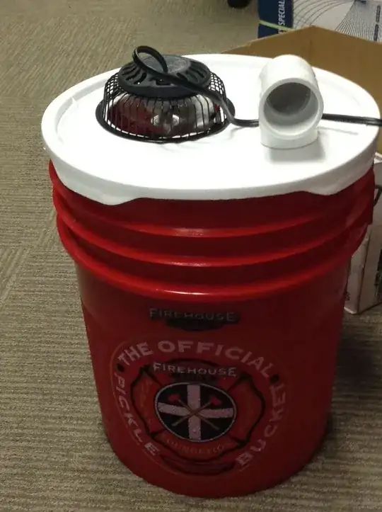

There are lots of variations on the 5 gallon bucket air conditioner. Uses ice made in your freezer and inexpensive fans. Google "5 gallon bucket air conditioner". One example
http://www.instructables.com/id/5-Gallon-Bucket-Air-Conditioner/
The basic idea is to load the bucket with ice you've made in the freezer and a fan forces air over the ice - blowing out cold air. If you have a long unattended duration, perhaps a larger bucket would help.
