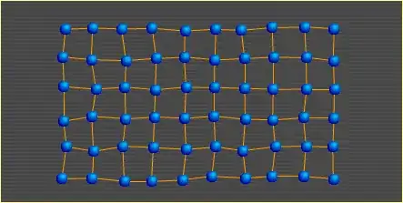

Temperature is the measure of the average kinetic energy of the molecules of a substance. That is, the molecules are moving in any substance warmer than absolute zero and the faster they are moving, the higher the temperature. When you heat something, you are adding kinetic energy to the system. This is literally causing the molecules of the bolt to move more and more quickly. In a solid, the molecules are not moving freely in space and essentially vibrate. The following image is a depiction of how metal molecules move when heated.
I think it's possible that this energetic movement could, by itself create the same effect as the shockwave caused by a sharp knock. That and an uneven change in size of the bolt and nut could break the static friction and/or shatter the brittle rust. I know that if you have a rusted cast iron skillet, one solution is to put it in a hot fire and the rust will simply fall off.
