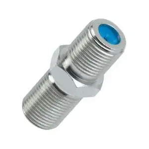

I believe it is splitting the signal, each output will have a specific loss associated. Some splitters will unevenly split the signal (commonly called a tap), which is handy to give a better signal to a longer run or to the cable modem. You can get a straight through connector at any HI store. That said, even these will have some loss of signal, just no where near as much as from a splitter.

Power dividers do the same thing. They work less well and generate reflections and other problems when their outputs are left open. One solution would be to properly terminate each of the output ports with a 75 ohm impedance which would reduce the interference problems. But, it would be much better to replace it with an adapter (straight through connector) which properly joins the two cables.
