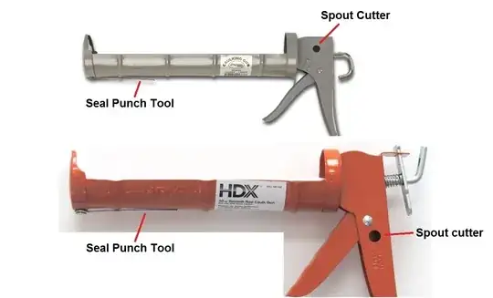

Is there a tool especially designed for opening a tube of caulk, silicone, or construction adhesive?

Yes! the tool is called a caulk gun. Use the spout cutter for cutting off the tip of the tube; then use the seal punch tool for poking holes in the foil seal.

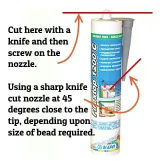

For UK users there is no separate seal as such, it's part of the tube itself. The top of the threaded part that goes into the nozzle is cut off using a craft knife.
UK type caulk tubes

A knife to cut the tip at the desired spot, and a nail to puncture the seal inside. You'll use the nail later to hold the partially-used tube.
