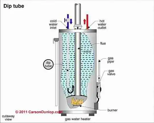

If you've got a gas water heater, there is a common problem that can occur with certain models. Because of the way they're designed, many have a "dip tube" that sits underneath the cold water inlet. It runs most of the length down the heater and channels incoming cold water down to the bottom of the tank where it can be heated closest to the flame.
If this breaks off part way (which I have had a few do, due to deterioriation of the plastic material), the net effect is that cold water is mixed near the top of the tank as the water is taken from the tank and it seems like it's running cooler or running out of hot water quickly.
You can pretty easily verify this by disconnecting the cold water inlet pipe from the top of the heater and carefully removing the dip tube to check its length.
For all the trouble, it's a couple-dollar part that can be ordered from the water heater manufacturer or a supply shop.
Shut the cold water supply off near the inlet, remove it, and pull the old dip tube flange out. Replace the tube with a new one, and secure the cold water inlet connection per code.
Hot water is again your reward.

The same defect happened to me a few years ago on my gas water heater. Hot water would last only a few minutes and then only cold water would be coming out.
The cause of my problem was that my dip tube, which send the incoming cold water from the top of the heater down to the bottom, was broken somewhere close to the top. After the tube sends new cold water all the way to the bottom near the flames (gas) or heating element (electric), once the water heats up, it goes up to the top of the heater, ready to be supplied out across the piping system:
If the tube is broken (typically at the top but could be anywhere along), which happens due to some chemical corrosion which I can't explain (perhaps minerals in the water, not sure), the incoming water does not reach the bottom of the heater, making the distance between the cold water and the heat larger, which reduces the amount of hot water your heater produces.
My gut feeling is that this is what your problem is. To check, you will need to dismount the (hopefully) flexible connector between the cold water supply pipe ends and the heater (I say hopefully because some people cut corners and run the pipe all the way to the heater, which is bad because it makes it harder to take things apart), and twist the socket off as the dip tube is mounted to it on the other side. When you pull it out, if the tube is much shorter than the heater, or the ending shows obvious signs of breakage, it means you need to replace the dip tube.
Hope this helps.
