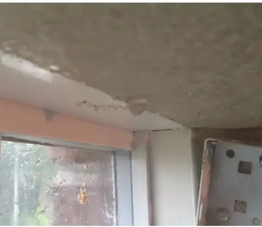

One room in the front of our house leaks during a hard driving rain storms. The leaks are at the top of the window and at the floor -- both locations which seem to correspond to locations of weep holes in the exterior brick veneer.
Here is a picture of where it leaks at the top of the window.

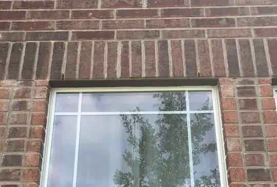

Here is a picture of the weep holes:
My question: is it possible the rain is being driven into the weep holes? Or is this more likely clogged weep holes? Or is this an issue with the way it was built?

"is it possible the rain is being driven into the weep holes?"
  • yes, but the weep holes are supposed to be on the outside of a moisture barrier, so rain driven in still should not enter the house.
"is this more likely clogged weep holes?"
  • no, the holes are designed to "weep", and are difficult to completely clog.
"is this an issue with the way it was built?"
  • yes, I suspect a structural defect such as incorrectly installed flashing above the window or inadequate/incorrectly installed moisture barrier.
You absolutely should pursue repairs through the builder's warranty.
