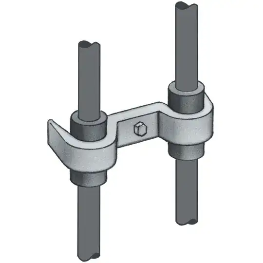

What I want is something like this picture but the poles will be free standing in the air, not againt a wall. Imagine that the one on the left is attached to the building and is sticking out of the roof. I want to get another pole (the one on the right) to be clamped on (possible two clamps) to the pole sticking out of the roof.

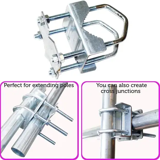

EDIT: Here's an image of what I want, don't know what it's called. enter image description here

That is called a Shelly pole/mast clamp. If you are extending a fairly light load like you show, an antenna or other such fairly light, non load bearing use, then this is fine.
For anything structural, or carrying live loads, this is the wrong product as you want to carry the load directly from top to bottom not laterally like this product does.
