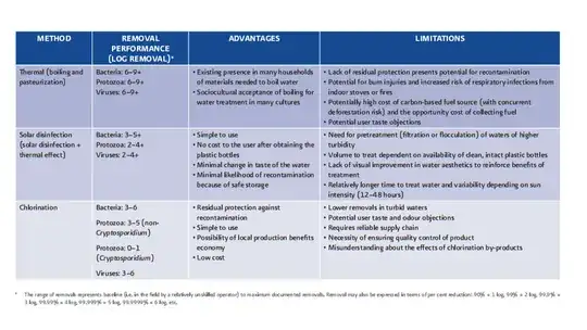

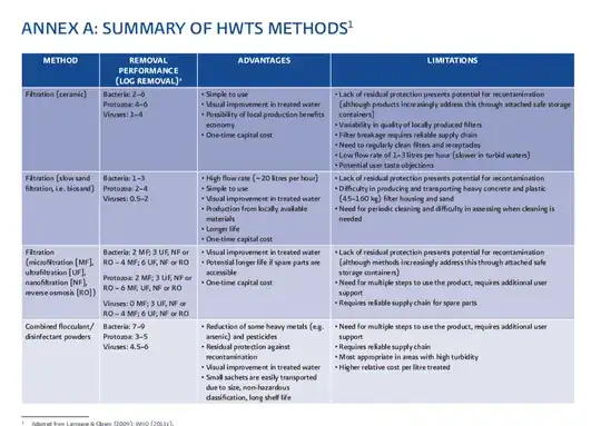

The World Health Organisation (WHO) publish "A toolkit for monitoring and evaluating household water treatment and safe storage programmes" (HWTS):
Several HWTS methods have been proven to significantly improve drinking-water quality in the laboratory and in field trials in developing countries . These HWTS methods include filtration, chemical disinfection, disinfection with heat (boiling, pasteurization) and flocculants/ disinfectants. In addition, a combination of these methods may be used to increase the efficacy of treatment.
Note that WHO cite "low cost" as an advantage of chlorination.
