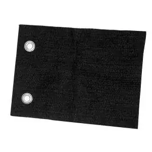

If you're worried about burning surrounding materials, you can use a heat shield.
There are all different types, sizes, and styles from many different manufacturers. This is just one example.
