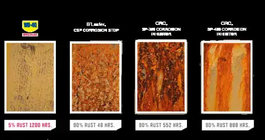

Or, you could use a specialty corrosion inhibitor spray like:
  • WD-40 Specialist Long Term Corrosion Inhibitor Spray - The company website advertises a comparison against some other methods with this image enter image description here
    but Amazon might have some less biased reviews.
