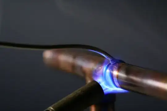

What Danny said - someone didn't use a flame shield while soldering the pipe.
The soldering process involves blasting the copper pipe with a hot flame until the lead solder melts:
A RESPONSIBLE plumber will use a flame retardant barrier while soldering. Whoever did your pipes just chose not to and nearly burned down your house.
