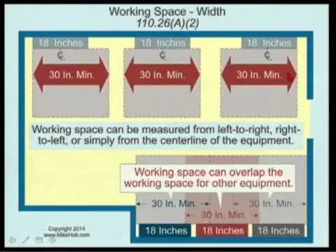

Per the NEC there is 36" clearance needed by a circuit panel. Is that 36" clearance just in front of panel, or is 36" clearance mandatory on the left / right and in front?
Howard
The clearance is 36" in front and 30" side-to-side -- but that side-to-side clearance does not have to be centered on the panel as long as both edges are accessible.
Graphically, originally from Mike Holt: Mike Holt's illustration of clear working space
