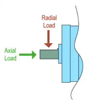

Radial loads are bad. Axial loads are good. The bearings in your drill or drill press are designed to counteract the forces in line with the drill bit. A milling machine does both, and using a drill or drill press like a milling machine will destroy the bearings quickly.
Radial vs Axial Load diagram
