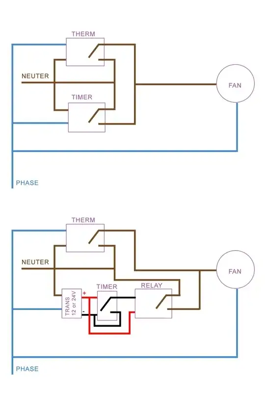

as the title: i have a room with with a heat generation that i need to keep under a certain temperature. Anyhow, i want to grant a minimum of air circulation even if the temperature is not reached (winter scenario) and i thought it can be a good idea to connect a thermostat and a timer in parallel to the air extractor (set for 10 minutes every 2/3 hours for example). In this scenario, if the temperature is reached, the fan is working thanks to the thermostat, if is not reached for as long as 2 hours, the fan is activated by the timer.
Thanks for help!
Jacopo
When it calls for fan, the thermostat is going to short the R wire to the fan-control wire.
You are proposing a timer which also shorts the R wire to the fan-control wire.
Assuming it's all this simple.
For the timer, easy enough: use any common lamp timer which allows hourly on/off. Plug a "wall wart" type transformer into that which makes 24VAC. Then add a 24V relay in the right place that connects R to the fan-control wire. This way everything is Code and the most vulnerable component - the timer - is easily replaced.
The arm-waving magic inside the furnace is what concerns me. If you want help with that, you'll need to be a lot more specific.
