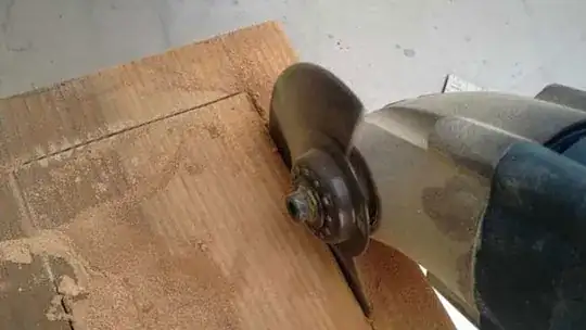

Multi-Cutter Tool

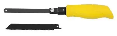

Hacksaw blade holder

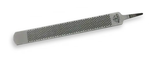

Rasp

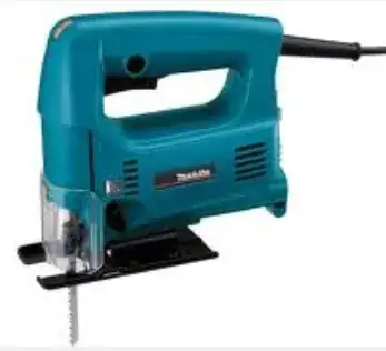

There is also this type of saw that may work ok for this job:
This type has a lot more control than a larger reciprocating saw because the base rests on the surface of the decking board. These do have disadvantages in that when cutting thicker materials the blade can wander from straight down and create a cut that is not square with the surface. This can be controlled to a large degree by quality of the tool, blade selection and limiting the feed rate in the cut.
One advantage with this is that there would be no need to cut the larger diameter hole. Just two corner holes would be all that was needed.
