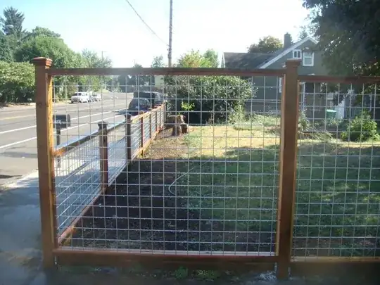

Something like this, but with slightly thinner/flimsier wire: enter image description here
