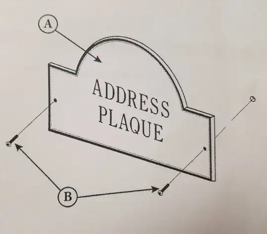

I need to install house numbers on my house. I have obtained an aluminium plaque with the numbers and I'm now wondering the best way to install it onto the house.
The house has vinyl siding, and underneath the siding is ZIP system sheathing.

The plaque comes with screws and is clearly intended to be screwed in, as described in the instructions. I would just follow the directions exactly but they do not mention vinyl siding or dealing with exposure to water, something that I've been warned to be concerned about.
Instructions for Plaque Installation
