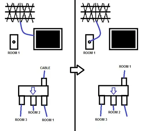

I have a reasonably good, 4-bay antenna in an upper room (Room 1) in my house. It gets a good number of channels, a fairly thick sprinkling between channel 2 through 62. I wanted to try routing the signal from that antenna to my other 2 TVs. So... I temporarily disconnected my antenna from the TV, and instead plugged the antenna into the wall outlet. I routed the Room 1 cable to the input of the splitter, which splits the antenna to Rooms 2 and 3. The following bad diagram explains what I did.
See bad diagram below: What I Did

You might try replacing the splitters. I had one outside a condo failing in such a way that it caused low frequency signals (<50 MHz) to be severely attenuated but higher frequency signals passed quite well. The result was that analog U.S. television channels 2 through 4 were garbage, 5 and 6 were snowy, and the cable modem worked very poorly. In this case, I think the splitters were degraded by flooding (high river levels submerged them for a couple days).
wallyk
  • 12,399
The attenuation of the signal does go up as the frequency goes up, as you have witnessed. Try a signal amp where at the antenna end, and verify the splitter you are using is rated for the correct frequency. You could also try a new run of cable as a test.
Not also that a two way splitter will loose 3.5db average on each output. A three way splitter internally "re-splits" one of the 2 way outputs, and causes another 3.5db loss on it's two outputs, so you have a 7db loss on each output.
I'm guess the amp will work, or a two way splitter.
