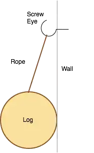

I have a log that I want to hang against the wall, creating a small shelf. I'm attaching the logs to two iron screw eyes using 1/4" hemp rope, for a rustic look. Here's a diagram:
Diagram of the log attached to the screw eye

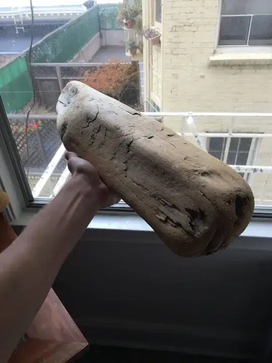

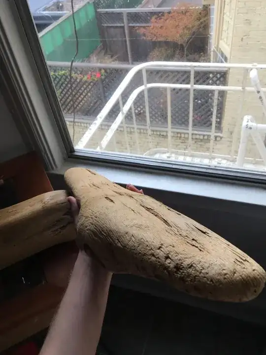

The screw eyes don't have a closed loop; they're open-ended like a hook. The log itself is very lightweight, and I don't plan on storing anything heavy on the log itself. The two candidate logs have several flat edges, they're not perfectly circular (see pictures below).
What knots/hitches should I use to attach the rope to the log and screw eye? My main goals would be to have a secure hold on the log. Beyond that, having an aesthetically pleasing hitch would be nice, too.

Here are images of the two candidate logs (I'll only use one, unless I do this project twice):
Log 1 Log 2

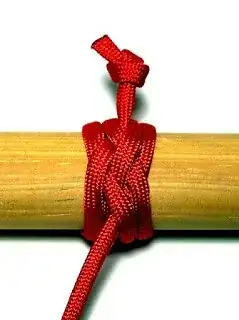

A boom hitch (ABoK #1687), might look nice around the log.
