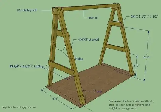

I would like to build the A-frame swing structure. One end of the beam attaches to the playhouse. The other end is the A-frame and I plan to use 4x8x12 treated lumber as the beam since I already bought one extra from previous project.

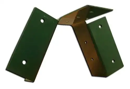

I have been researching for the mounting bracket but most would say to support 4x6 beam only like this
Source: http://www.swingworks.com/product-p/11-5010.htm

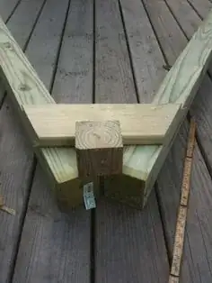

I rather not use multiple lumber pieces to build the horizontal support like this because we think it's somewhat "ugly":
OR this (using 4x8 instead):

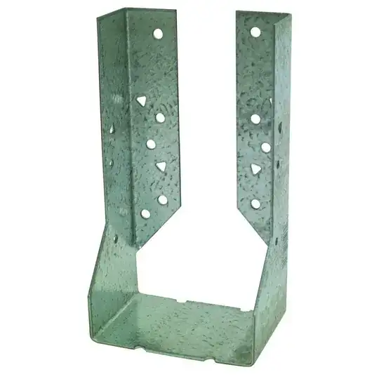

  1. Is there some kind of bracket from home improvement store that I could use? I am thinking of using "4 in. x 8 in. Concealed Face Mount Joist Hanger" like below

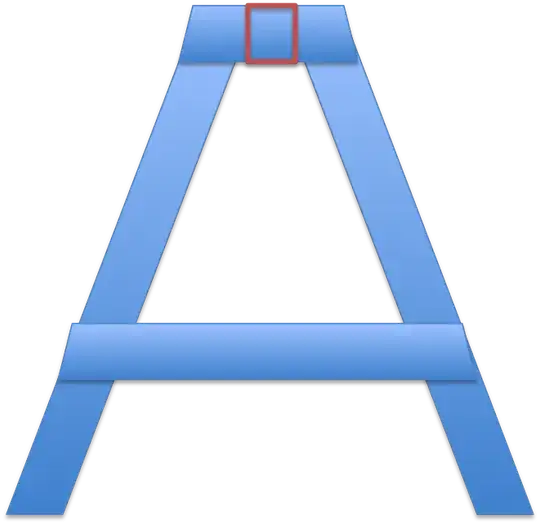

..and then install it as in the "red" box in this picture:
  1. Could I use the 4x6 bracket for 4x8 lumber?
  2. Or best, is there one bracket purposely built for 4x8 lumber?
I could buy a new 4x6 for this but would rather use the existing 4x8 that already laying around in my backyard.

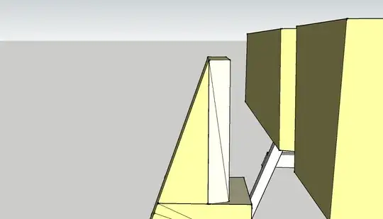

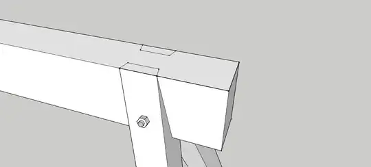

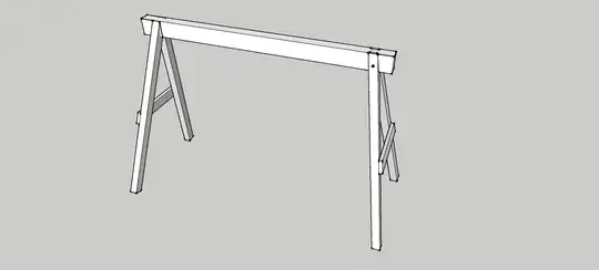

I would refrain from using that type of fastener. I believe it will allow a lot of movement. I made a sketch to show what I have made before, many years ago. It does not have any hangers just angled notches that allow the legs to fit tightly and notches that act as a setting for the beam to bear on. A single bolt will draw it all together, or two could be used.swing1 swing2
The legs are also splayed to help stabilize the swingset, and give more room for the swings.
7/12/2016 Edit

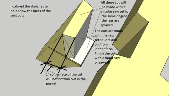

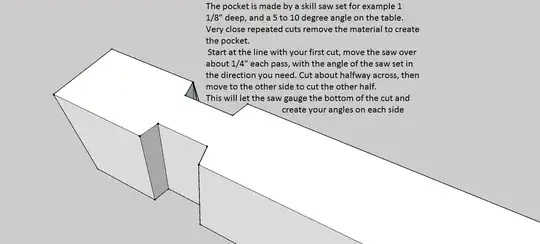

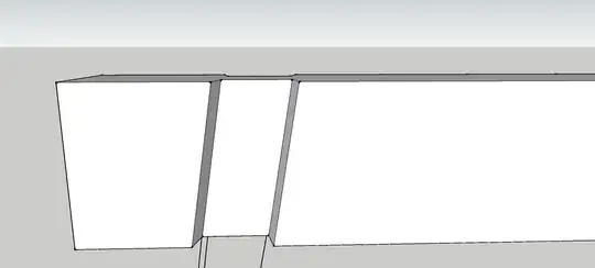

All it really takes is a circular saw set at 5 degrees or so. No set angle, just something that would draw tight as the bolt tightens. The notches on the beam are the same depth alll the way through. Just determine the angle you want the legs to splay at and make sure the overall width of the cut on the side is no wider than the leg material, otherwise the fit may be loose. The legs are what is cut at the angle. I added some sketches to help elaborate a little.
enter image description here enter image description here enter image description here enter image description here
I hope it helps.
