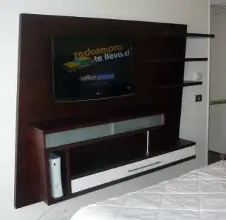

For instance, I would like to do things like this:
Hanging piece of furniture
It's hung with 5 screws. The whole thing weighs approximately 50kg (110 pounds) so we can say that each screw holds approximately 10kg (22 pounds).
The person who installed it said it was fine, but is it really?
Do somebody know a study or some numbers regarding how much weight this material can stand?
EDIT: Just to clarify, it's not screwed to the studs. It's screwed to the drywall.

The picture it is a entertainment center. The TV is attached to that not the drywall. Being in construction for 40 years and a drywall specialist no you should not hang heavy items on drywall without proper anchors or it will not last for a long time.
Ed Beal
  • 103,727
  • 79
  • 158
