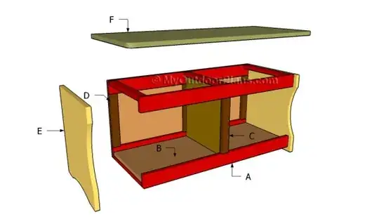

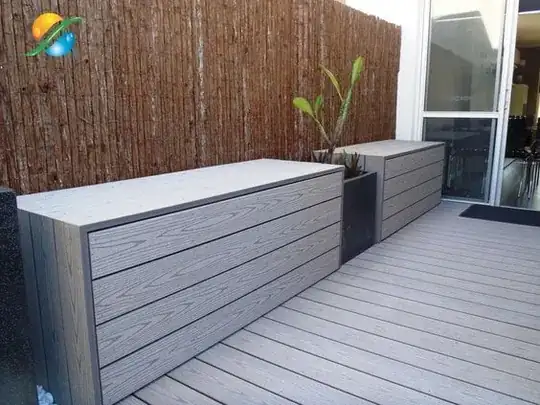

I want to build a bench like this that can open on top to storage stuffs inside
Source: http://myoutdoorplans.com/bench/storage-bench-plans/
I will use composite decking boards (extra got left over) to build the outside. BUT how do prevent water from getting inside? I could make the top cover using outdoor plywood and put composite deck on top but that would be too heavy for the top to open up. Is it possible to use paper / flashing thing to put in the inside?
Thanks.

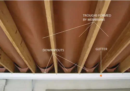

UPDATE
So I guess I am thinking about using this membrane but only all small 2x8 section:
Source: http://www.hometips.com/diy-how-to/create-waterproof-dry-space-under-deck.html
But this is Trex RainEscape which could be expensive. Can I use flashing paper or some membrane for tile or roof instead?

For the lid, you'll need to support the decking as frequently as it is supported on the deck itself. If your deck joists run every 12" or 16", you'll need to replicate that or the lid will sag. The photo shows benches that are sixty inches long. You diagram show one support in the middle, leaving a 30" span. At summer temperatures, it will be sagging within a week even with zero use.
Larry
If the top is hinged and is overlapping the sides, you could put 1/4 to 1/2 inch rubber weather stripping on the inside of the cover or on the frame to give yourself a nice water resistant seal.
