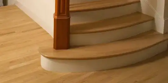

However, you can partially mitigate the visual intrusion of the rails into the space by using a starting step:
