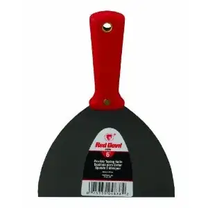

When patching smaller holes, a 6" taping knife should suffice. enter image description here
Apply the compound in a few light coats rather than a single heavy coat, and sand between each coat.
You can either sand the patch using a sanding block like the 3M® Fine/Medium Large Drywall Sanding Sponge,
or wet sand using a slightly damp rag. If you choose to wet sand, let the area dry before applying the next coat.
For larger holes, you'll have to fill the hole with something solid before you apply compound (don't try to fill the hole with mud). Once the hole is filled, start with a 6" taping knife for the first coat. Next, apply a few thin coats using a 10" taping knife
feathering the compound out to blend into the wall.

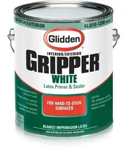

Wipe the wall down with a dry rag, to remove any dust and dirt. Prime the whole wall with a proper primer, like Glidden Gripper.
Any time you patch, it's a good idea to prime the entire wall. If you simply prime the patches, you may be able to see the patches when you're done.
