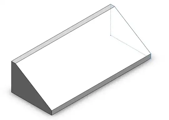

I'm trying to make a pet gravesite marker out of concrete. Here is what it will roughly look like.
Model
It'll be about 2' long. It's going to be located in the mountains. Elevation is 4070', record low temps were -24deg, avg lowest yearly temp is 18deg. Lots of rain and tons of snow. Average highs are in the low 90's.
I'm going to need to make it to last. I work at a metal shop, so I plan to cut metal inserts, such as: a silhouette, name, birth/death date, and maybe a decorative border. I plan to stain it black so that it matches the horse's show colors of black and silver. I also wouldn't mind some light flakes of some kind to make the black pop a little. I haven't worked that out yet.
I'll build a form with the face open and level. I'll pour in the concrete and then set the inserts into the face while it cures. I'll use a hand sander and stick to vibrate the form and remove air bubbles and inclusions. I'll sand the face and metal inserts flush to accommodate any shrinking that occurred and make sure the face is perfectly flush. I'll buff the metal till it's bright and scratch free. After curing, I'll see if the inserts are easily removable. If they are, I'll remove them before staining. Lastly, I'll seal it against tarnish and the elements.
I should end up with a headstone shaped approximately like the one pictured and it'll be black (possibly with small metallic flakes) with silver looking inserts.

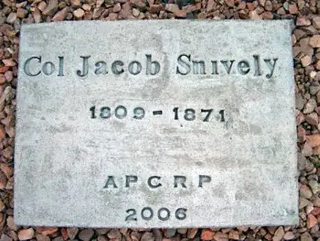

This DiY Headstone suggests high strength mortar mix.

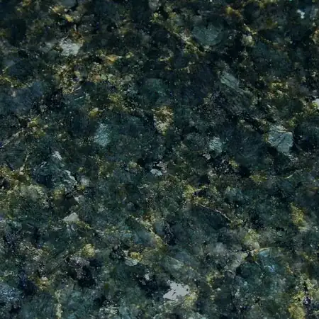

I'd suggest Uba Tuba for its flakes:

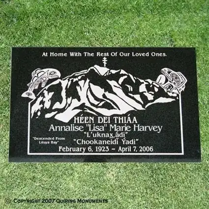

Truly though, what I'd recommend, is having a real stone cut for you. They're not as expensive as I would've thought. Even a somewhat fancy one should be under a grand. But it doesn't really matter what we think... what does The Boss want?
This:
Or this:
Food for thought, regarding the fact that you're a metalsmith, if your only tool is a hammer...
If it needs to last, then it needs to be made out of granite.

I have found that using an inexpensive plastic container as a mold works quite well. Use painter's tape where writing and numbers will be and glue them to the tape, then trim the tape with razor knife close to the writing. (remember writing mus be backwards!) I prefer the fiberglass type concrete to the quickrete (rock and sand) type used for the two you see here. Use the quality concrete colorant and mix it very well before adding to the concrete. Take your time working all the air bubbles out without disturbing the foam letters and numbers. Set mold at proper angle and let dry for 20-30 days.
