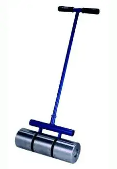

When installing vinyl, it should be unrolled slowly, with even pressure being applied along the length of the floor as it's being unrolled (slow, tedious work) and then when it's down a floor roller should be used over the entire floor, working from the center to the edges, to push air out.
Big bubbles means this wasn't done - it was put down in a hurry. If the adhesive has set up already, it is almost impossible that they'll be able to pull it up again w/o destroying the vinyl.
