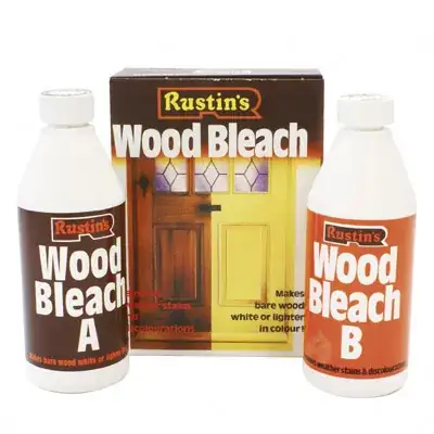

If you want a lighter stain, you'll need wood bleach. Wood bleach is an iffy proposition, but your odds are good since you don't need to get it all the way back to the original shade and the stain isn't that old. I'm assuming in this answer you used a pigment-based stain (most are).
  1. First apply the mineral spirits. This may lighten the stain some. Let it dry a couple days. If you're lucky, you'll be happy with this color and can finish with a clear coat.
  2. If not, get some two part A/B wood bleach. enter image description here
    (source: willyvanhoutte.be)
    This is a two part preoxide based bleach (NaOH and H2O2).
