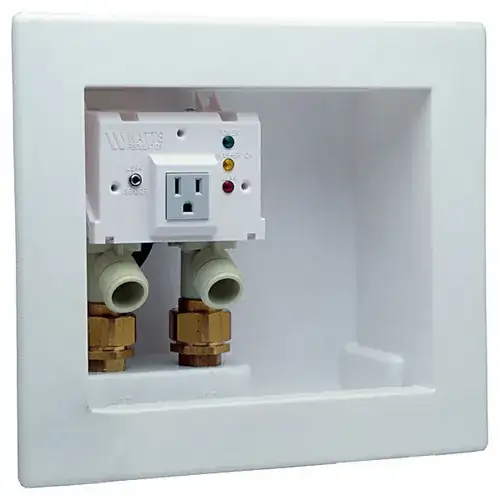

Perhaps your BEST prevention, however, is an automatic washing machine shut off valve:
This device has an attached sensor (pic 2) which you set on the floor by your washing machine. In the event of a leaky washer OR failed hose, it senses the water and shuts off the flow at the source. For an under $200 investment, if you're protecting a $20,000 basement or worse, a whole house, not installing this once you know of it's existence would be downright foolish.

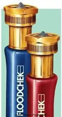

In addition to what Greebo said, they also make hoses with the shutoff built into the hose, but the reviews on these are pretty bad and won't stop a small leak.
