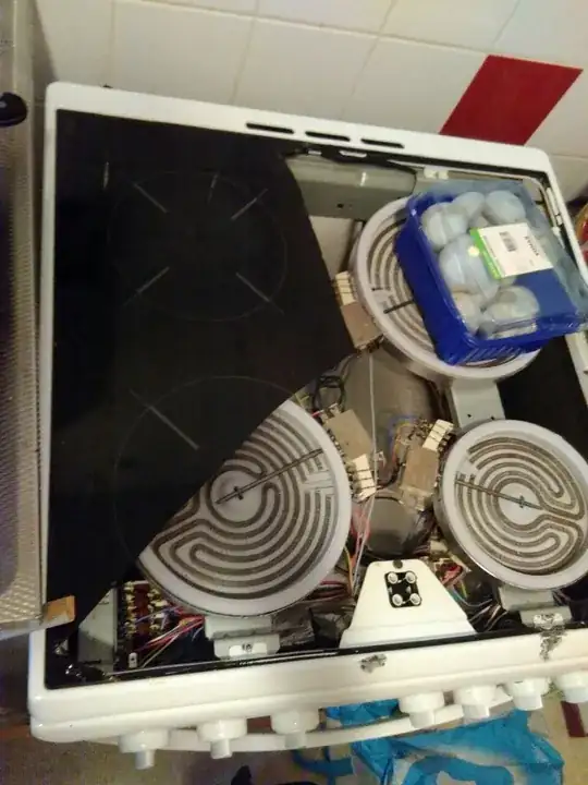

The glass plate of my ceramic stove cracked (Indesit K6C51), and I'm looking to replace the ceramic glass.
(I know about What are some alternatives for a glass stove top replacement?, but somehow the answers were not quite satisfactory.)
cracked ceramic stove
The coils you see get very hot, and it seems like the only thing that the glass does is transfer the heat from the coils to the pan.
I have found an original part of around ~$300, which I think is pretty expensive. I'm not very sentimental about the looks of the stove, as long as I can cook on it. So I'm thinking of putting in a (clear) ceramic glass sheet that I know people use for wood stoves such as Robax or Neoceram, which costs me around ~$150.
My question: will this actually work?
My reasoning is that I could put in any heat resistent glass with low heat conduction coefficient (so not the entire plate heats up), but I would like to be sure before I spend money on it.
I have looked into both borosilicate glass, and glass-ceramics. Both are very heat resistent, but only the latter seems to be used for cooktops. Is that because borosilicate breaks easier?

Borosilicate is commonly used for chemistry and cooking. A common name for borosilicate glass is Pyrex. Borosilicates are acid resistant and have low expansion upon heating. However, borosilicates are not as durable as ceramics.
Technically, the kind of glass used on your oven is probably either Ceran (made by Schott) Li2O-Al2O3-Si2O2 or Pyroceram (made by corning) Li2Si2O5. Ceramic glass is probably the best choice.
So a lithium or lithium-aluminum ceramic is probably what you need, especially because of the resistance to thermal shock which is extremely likely- as food will spill on it. If you doused a woodstove window with water, it would surely crack.
The Robax or Neoceram that you allude to, actually appear to be the ceramic glass used on ovens... and they are just attempting to sell them for wood stoves.
