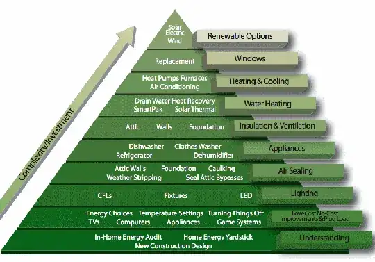

Installing solar should be one of the last things you do. You should first concentrate on those things that will reduce the amount of energy you will be using. "The Green Building Advisor" has a good article on The Energy Efficiency Pyramid.
pyramid illustrating simpler, more cost effective energy conservation methods provide the foundation for more complex and costlier solutions at the top
I believe this article will help you make some wise decisions about where to start.
