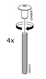

Some of the screws needed for the assembly come in 2 parts: the head and the threads. You screw the head onto the threads and then use that on the couch. Here's what that looks like:
Screw head and body
How do I remove these screws? When I try to unscrew them only the head comes out, leaving the thread part in the couch. I have a lot of extras, so would using a screw extractor work? I don't mind if the screws currently in the couch get ruined/tossed.

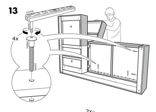

The way these are assembled means that the parts they hold together remain together even if the head is removed. It effectively becomes a pin on two sides of a box and prevents the box from being slid off the pin. Shown in step 13.
EDIT: My plan now is to unscrew the screws in step 14 of the assembly guide and then use a thread locker/screw extractor on the back screws in step 7. This should hopefully allow me to split the 2 sections of the couch albeit with the armrest/back still attached.

I have that exact same couch, and the solution is pretty simple: Just ignore it at first. I had to take it apart as well - I didn't even notice that some of the heads came off until I got further down the line in taking it apart. Just follow the instructions backwards - The first time you will run into those screws is at Step 13. Take all those out, and if only the head comes off, it doesn't matter. The head is what's holding it together, now that you've removed it, you can do step 12 in reverse - you'll just have the two rods sticking out of that thing you just took off, whatever it's called. They can generally be taken out/unscrewed by hand - worst case scenario, you'll need a wrench, but it shouldn't be necessary. The same then goes for step 10 - take it off, and if only the heads come off, you'll have the two rods sticking out, again, take them out by hand. The same then goes for steps 7 and 6 - although here, you will need to reverse the steps starting with step 7, then jumping to 4, and then back to 6. Then everything should work without a hitch.

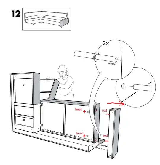

enter image description hereYou need to start with undoing step 12, that is slide the shortest armrest along the threaded rods. Same goes with step 4. It seems that the heads you've removed are the only thing actually holding the frame together. There might be some resistance because of threads created in the wood, I marked them with X, but imho it should be overcame with force.
