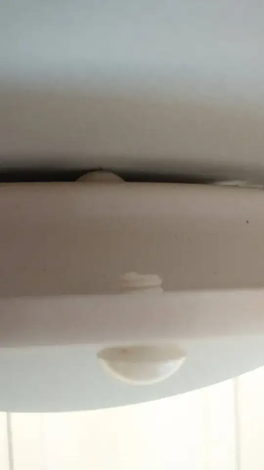

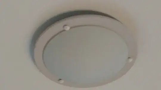

I have a couple of lighting fixtures in my apartment that look like this:
1]

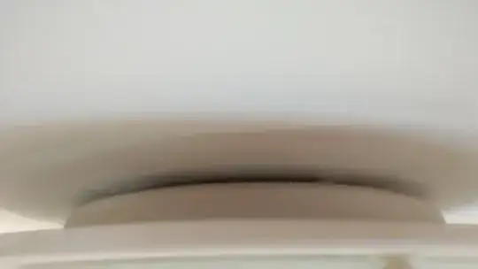

The metal base goes directly to the ceiling and the posts holding the glass dome, while threaded, do not turn or slide in any direction. I have tried rotating the whole fixture, but it seems to be moving the electrical box in the ceiling without loosening. How might this unit open? 2] 3]

I would think that the white screws that you show in the foreground of 3rd picture can be undone by hand while holding the glass. This would allow the glass to be removed, and the bulbs and mounting screws to be accessed.
Keith Procter
  • 524
This is years later but can confirm that the white posts unscrew. Mine were pretty tight but they do come off and the the globe just slips off.
